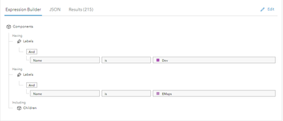

  1. Can you provide a sample configuration for how to set expression or labels for the following complicated case:
We have 2 labels “Dev” and “EFFMaps”, we can label a collection using the following Expression to make it have both properties, without creating a new label “Dev EFFMaps”. How to implement this in the Admin Utility?

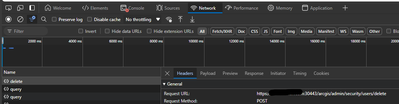

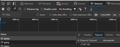

  5. But if you still would like to enhance it, the "reverse engineering" using web dev tools might be the easiest way.  For example, to delete users AndrewSakowicz_0-1720300507140.pngAndrewSakowicz_1-1720300555175.png
GeorgePan
Thanks so much for the quick feedback 🙂
Yes, reverse engineering is very helpful, and it has helped in finding some answers.
