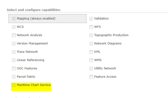

Using 11.1 I have installed ArcGIS Maritime and enabled the Maritime Chart Service for the 'Sample World Service.'
However I am trying to enable another Map Service - but the Chart Service Capability is greyed out and I am unable to select it
Any assistance is most appreciated

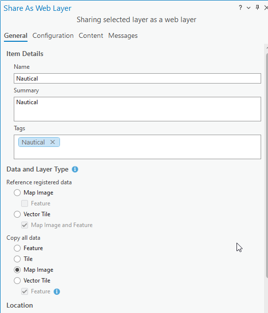

(Service was shared from ArcGIS Pro 3.1x)

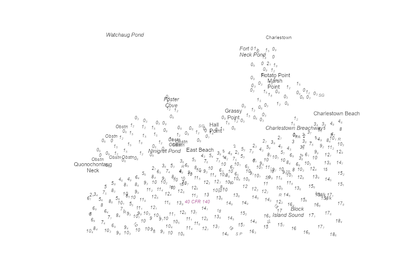

Snippet of data (As Map service)

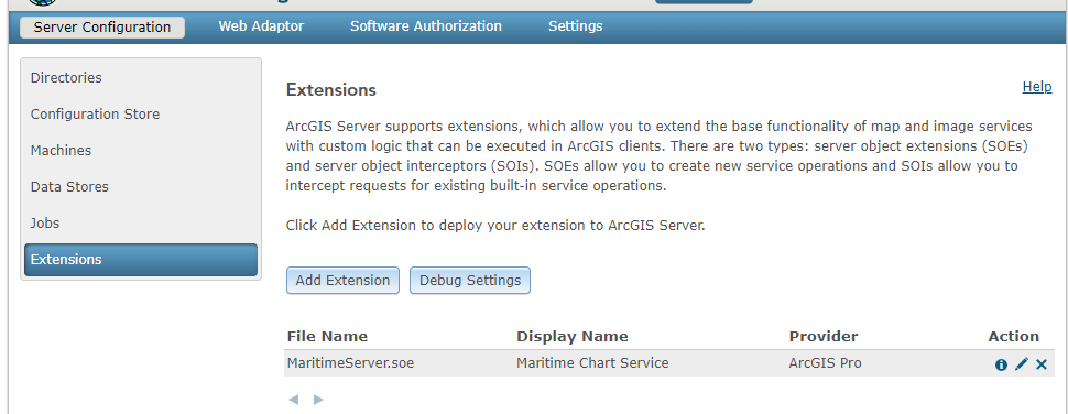

Steps outlined here have been followed too - Configure ArcGIS Maritime—ArcGIS Enterprise | Documentation for ArcGIS Enterprise

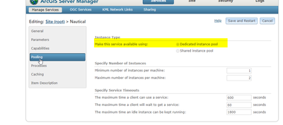

OK, got it working.
Needed to switch to Dedicated instance pooling
