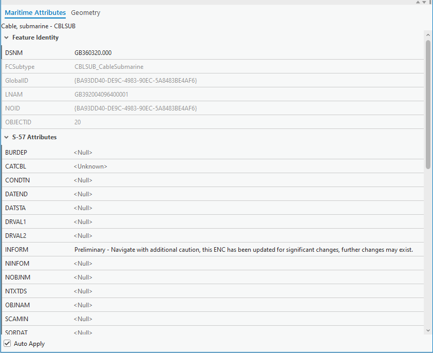

I noticed that when I create a maritime gdb from scratch (meaning I did not import any S-57 file.. I just created the GDB, imported the ENC XML file, then set the agency and compilation scale), I can't see the Maritime Attributes in the attributes window.
The Maritime Attributes only appear when I imported from an S-57 file like so
Is there anything I should be doing to the maritime GDB so I can view the Maritime Attributes? Or is this an issue with 3.1?

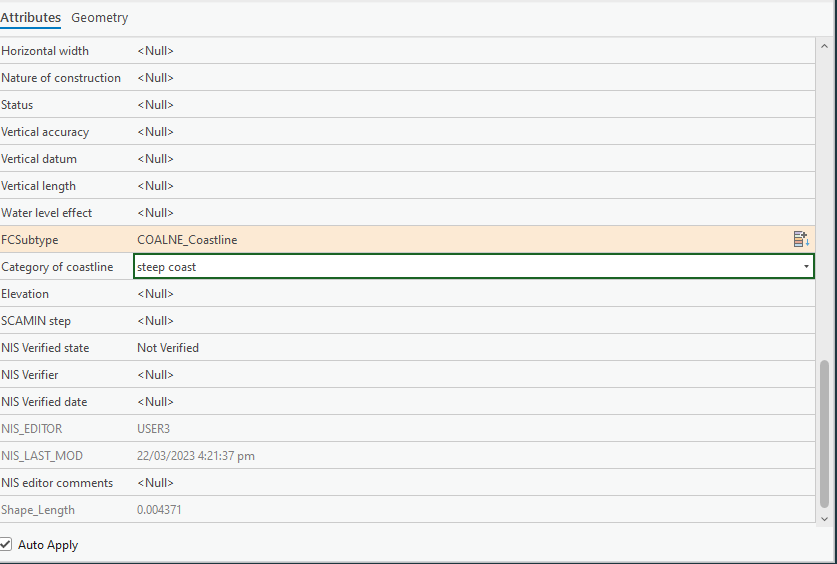

Thanks for the fast response. I now see what I did differently, I chose Import Schema only instead of Import data and schema. We've been used to just importing the schema so I did not think of this. I can now see the Maritime Attributes. Thanks!
