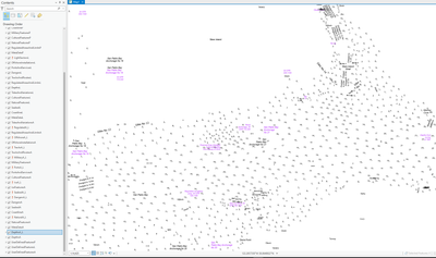

I've figured out how to import an ENC cell into a geodatabase, but cannot for the life of me get things to symbolize correctly.
Steps I have taken:
Create new file GDB
Import XML Workspace Document (NAUTICAL_ENC_TEMPLATE_GX_EXTCLSID.xml)
Run "Import S-57 to Geodatabase" tool

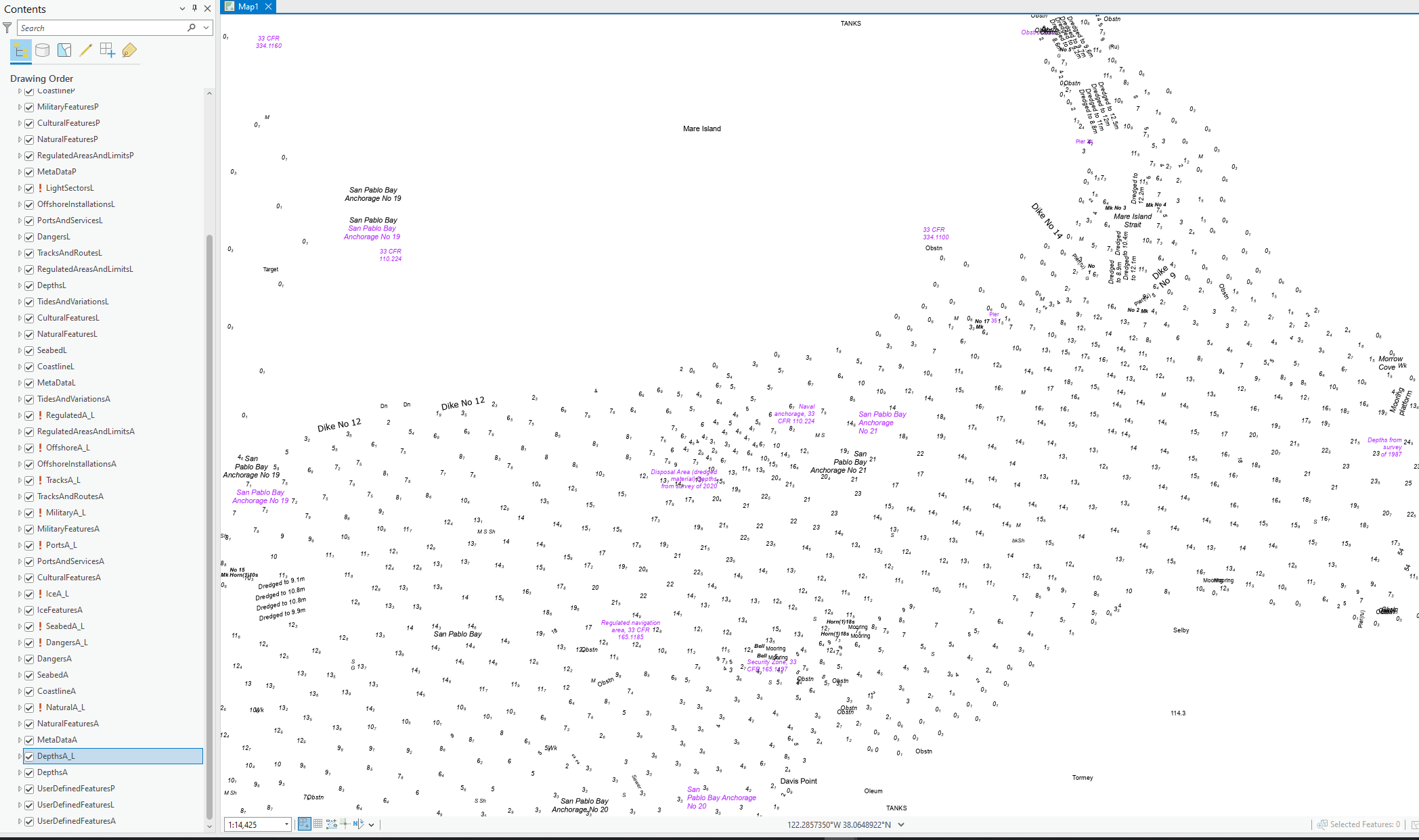

This is what I get when I add the geodatabase to a new map.

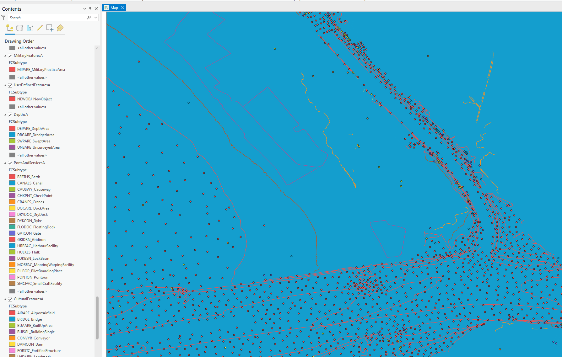

After a little research I discovered I can download the S-57 Nautical.lyrx. I add this layer to my map and repair data sources but am left with this mess.
I guess I just dont understand what I am doing wrong. For reference, the instructor included this .mxd file for use in ArcMap. When I import it into Arcpro it symbolizes fine and I am able to proceed with the next steps to edit the file.

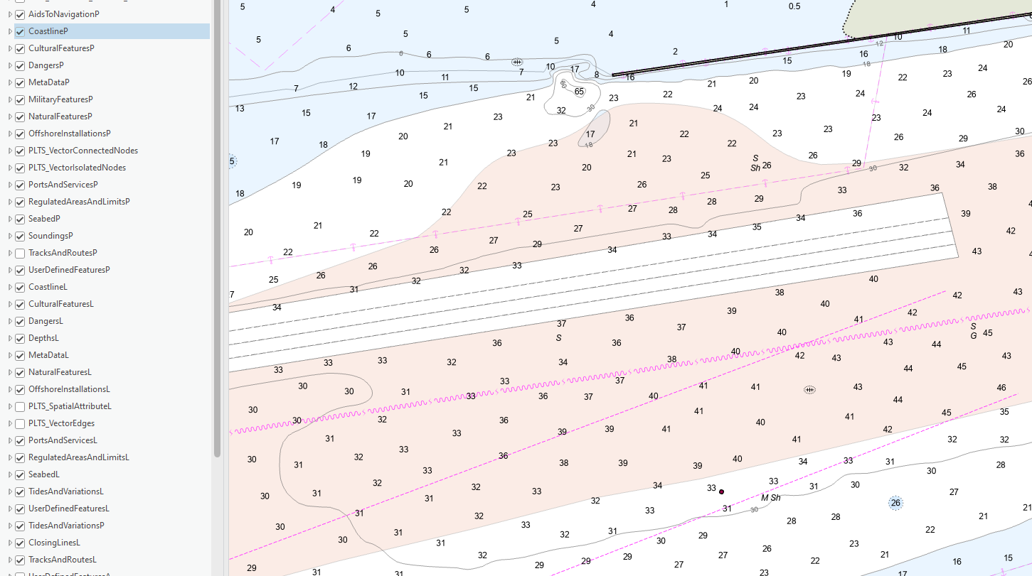

Hi - the Nautical.lyrx is meant for a specific paper charting workflow. In the same Maritime directory where you found the Nautical.lyrx (which was  under the Charting directory), there is an S-57 directory. In there you will find the Maritime.lyrx. Similar to what you did with the Nautical.lyrx, you just need to repair the data sources and you should be all set.

JoshuaWoodrow
Craig!
This is exactly what I was doing wrong, thanks for the point in the right direction.
