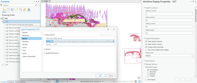

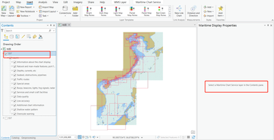

when I Select a Maritime Chart Service layer in content pane,the message is below:
How can I open the maritime display properties pane,
the Data Type is WMS Service.
the Server URL look likes below :
https://192.168.110.110/server/rest/services/SampleWorldCities/MapServer/exts/MaritimeChartService/W...?

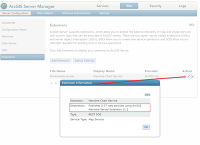

If it is not resolved, please check the SOE description in ArcGIS Server Manager and let me know what version 10.9.1 has been deployed.  ArcGIS Maritime Server extension has released update 4.  The update value will be in the description.  Here's an example from our 11.1 release.

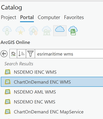

In your Catalog pane, through Portal, search ArcGIS Online using "esrimaritime wms" and load the ChartOnDemand ENC WMS service.  Does that work?

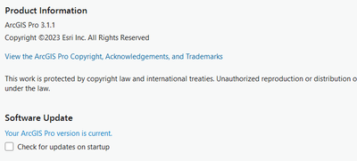

the Pro version is 3.1.1
The Arcgis Server and  ArcGIS Maritime server extension version is 10.9.1

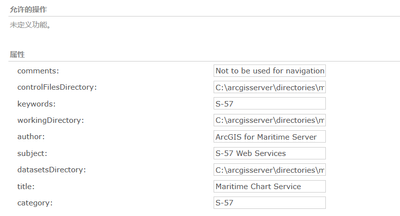

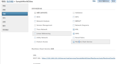

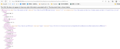

when I click the rest url (I visited server(hosted services)used IP), it looks like below:
and I can connected online maritime enc wms ,as you said
