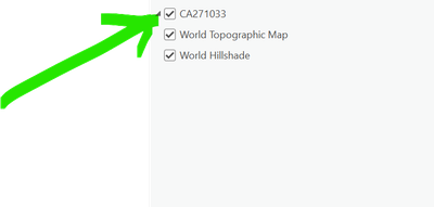

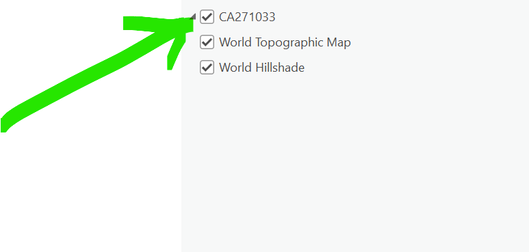

Hi, eveyone,
I hope someone have some ideas about this.
I brought in an ENC chart map. The map shows fine, but in the content pane, there is nothing displayed under the chart number. However, on one of my colleague's computers, all the sublayers are shown, allowing all the components to be turned on and off.
Thanks
J

CraigTGreene
The ability to expand the dataset and access the individual S-57 objects was released recently with ArcGIS Pro 3.3
My best guess is that you may be on an older version of ArcGIS Pro.
JerrieGeng
Thanks. I think you are right. I am updating now, need download the desktop runtime first. Hopefully will solve the issue.

JerrieGeng
Hi, L.
yes, after updating, It works great for me.
Maybe it is different issues to you.
