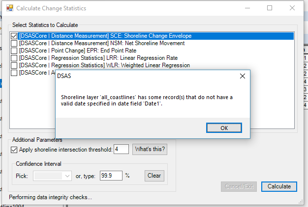

Hello  I am working with digital Shoreline Analysis System software developed by usgs for coastal zone analysis. When I try to generate the statistics, I get the following error message: Shoreline layer "all-coastlines" has some record (s) that do not have a valid date specified in date field "date_".  - I check: the date setting of my Date_ filed (MM/DD/YYYY), the dates are in this same format in my "all-coasltines" file too. - I tried to remove the "0" before the figure of the month (4/03/1989 instead of 04/03/1989) but no success.- The field "date_" is in text format, with 10 characters. I also tried different options with 22 length by adding times but no success.
Has anyone come across this problem?

Without knowing anything about this digital shoreline analysis system, have you checked the table contents in field Date1? Correct the invalid entries (perhaps Null) might be the place to start.

Yes. content has no issue. In fact I tried other solutions to check which record has problem for example splitting the date into halves and tried to identify the invalid records but it did not resolve the issue

In DSAS the dates must be 10 characters long. So 4/3/1989 MUST be expressed as 04/03/1989.

Indeed, this format is exactly what needs to be entered, thanks!
Be aware of :
-> backslashes as a separator
-> actual days, not 00/00/2020 like I did which gives an error
-> like mentioned, exactly 10 characters
