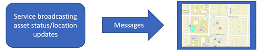

Regardless of the specific use, there is a common theme for how these applications work.  There is usually a feed or stream of data coming from a separate system delivering individual messages which give a status and position updates for items to be displayed on a map display.

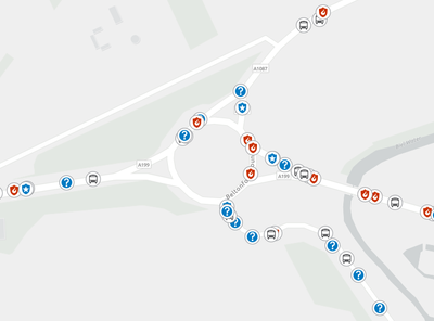

I will step through an application for an imaginary control centre for despatching and monitoring thousands of emergency vehicles. We will get regular system messages updating vehicle positions and the status of the vehicle which includes states for:
  • Available for new call
  • On route to call
  • Attending call location
  • Off duty
These different vehicle states will be used to show how these vehicle positions are rendered to the map.

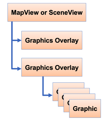

Going back to basics so we all understand where these graphics live, we should all be familiar with the UI control which displays your mapView (2D visualization) or your sceneView (3D visualization).  These controls have a collection where we can store several graphics overlays, each of which can contain multiple graphics.
Each graphic is defined by the following items:
  • A geometry (polyline, point or polygon typically)
  • A symbol to define how it is shown on the map (a red dot for example)
  • An optional set of attributes (like fields in a database record)
