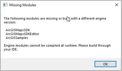

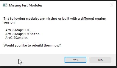

How to solve this ?
My installation :
Unreal Engine 5.1.1
Visual studio community 2019
5 Replies
muhnawir

Hi,
Can we please get some more information regarding this issue? Would you mind replying with a screenshot of the file explorer open to the project path where the .uproject is? Additionally, you can right click on the .uproject file, and select “Generate Visual Studio Project Files” and then open the visual studio solution file that appears. Once open, at the top select build followed by build solution. The console should open at the bottom. If you see “build succeeded”, try opening the project again. If you see “build failed” please send a screenshot of the console so we can better help you.
thanks,
Mason Gaw
MasonGaw
Additionally, could you please confirm if you installed the plugin to the project or to the engine? We are aware of an issue similar to yours when installing it to the engine. I'm happy to help you with a work around if that is the issue.

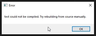

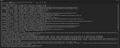

I am currently running into this same issue with Unreal 5.3 and Visual Studio 2022. This is my error list
And my output:
I have the Plugin installed into the project under the folder Plugins and am using version 1.5.
