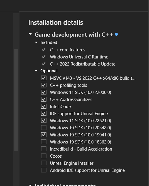

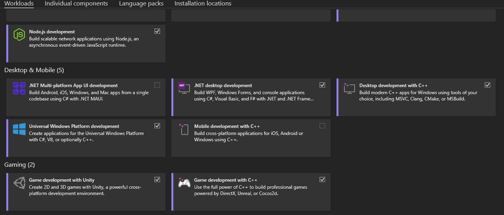

I have checked the VS installation as per documentation (using 5.2 page) and here are my settings
VS WorkloadsVS WorkloadsC++ game devC++ game dev
I have also applied optional settings as per the page. Unfortunately, that didn't help. Here is the copy of the output console.
