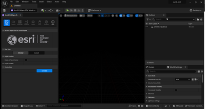

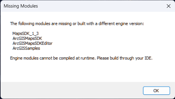

After creating new Unreal Engine 5.2.1 project and enabling Maps SDK 1.3 the below message is displayed

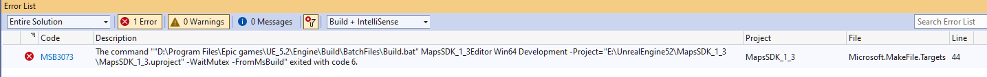

If I try building solution via Build, Build, <Project name> the  build process fails with message below.

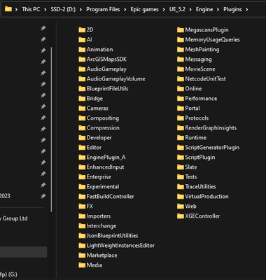

I prefer to install the plugin in Unreal Engine installation directory with all other plugins so it is available for all my projects.
In my case it is like below
Once I create the project I just have to enable the plugin and restart the editor. Obviously, in this case it produces the first error about different version of the engine.

MasonGaw
Hi,
I'm glad you were able to resolve your issue. We don't support engine installation for Unreal Versions 5.1 and 5.2. We do support it for 5.0, but this feature has been removed for new versions of Unreal.
Please let me know if you have any other issues or questions.
Mason

MasonGaw
Please allow me to correct wording. The Maps SDK supports Unreal Versions 5.0, 5.1, and 5.2, however to use it you must install the plugin to the project in versions 5.1 and 5.2. We do not support engine installation for versions other than Unreal 5.0. If you wish to install the plugin to the engine and have it accessible across all your projects, you will need to use Unreal 5.0. If you would like top utilize the newer features in Unreal 5.1 or 5.2, you will need to install the plugin per project.
I hope that clears things up for you.
Mason
