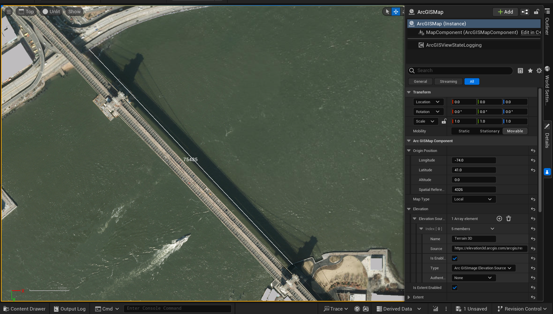

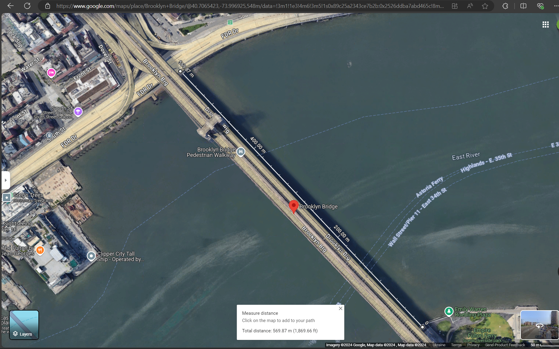

I conducted measurements of the Brooklyn Bridge as it appears on the flat map (Local Mode) and compared these with the real-world dimensions obtained from Google Maps in a browser. The results are as follows:
  • The length of the bridge in Unreal Engine is 1.32 times larger than its actual length and the length measured in Google Maps.

Measuring by google:

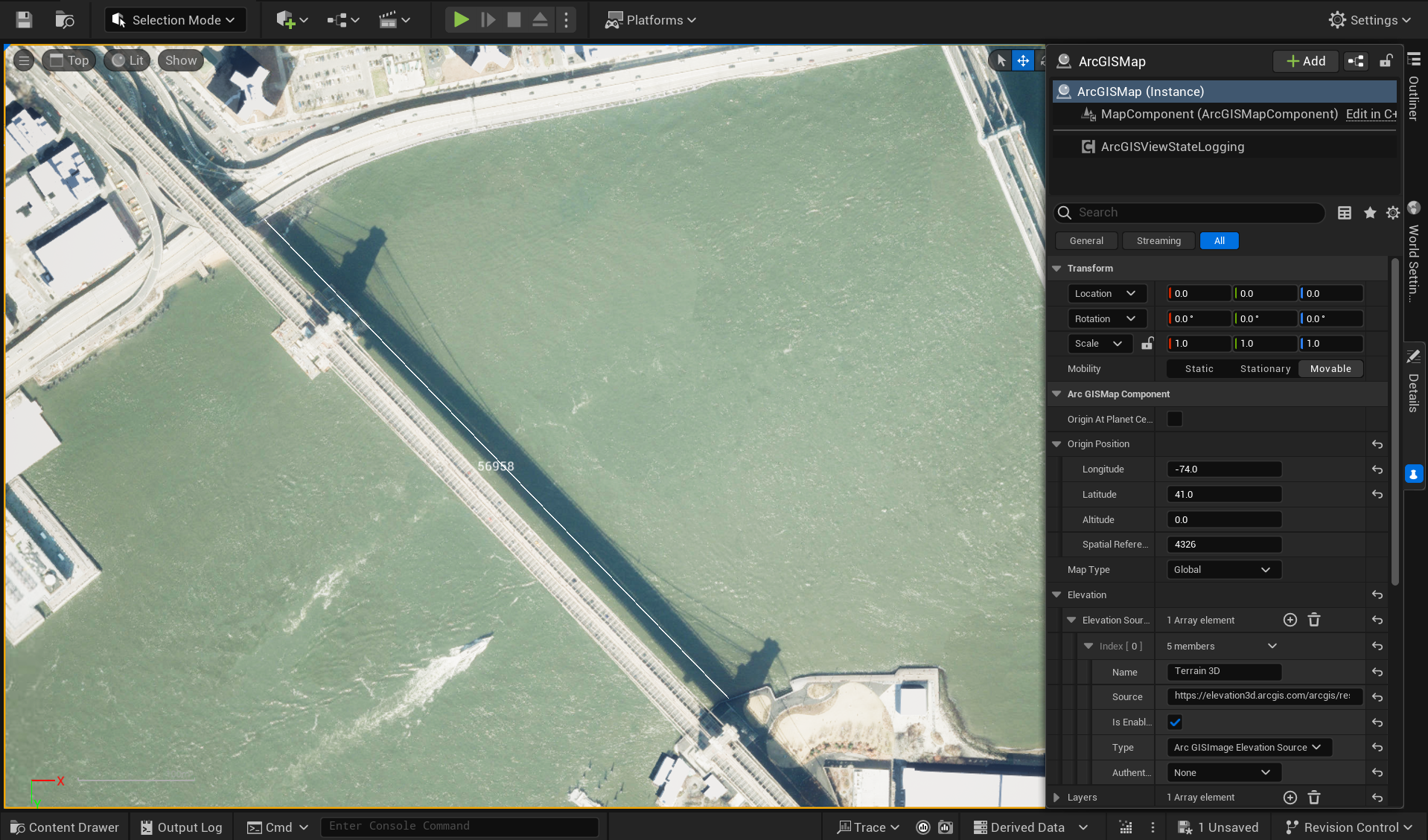

Measuring inside unreal engine. Map type (local)
Measuring inside unreal engine. Map type (global). Size similar with google.
