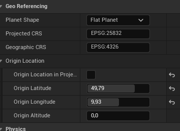

these are my configurations to georeference the lokal scene.

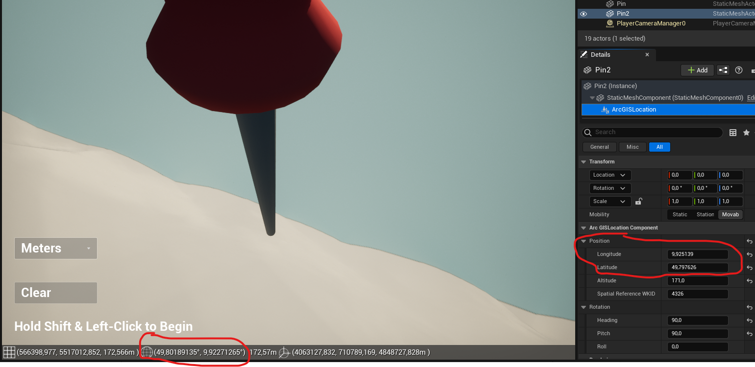

I noticed, when i place an Object in the local scene using the ArcGIS Location Component and travel there visualisng the coordinates with the UMG_GeoStatusBar, the coordinates are not the same.
I think that is because of the Plate Caree Projection and its distortion. When i am working with a global scene, the coordinates are the same. I hope someone has a solution for this Problem

I found the solution. I had to choose the 3857 WKID as a projected coordinate system. the following image of the spatial references section might be the explanation.

I see you have "EPSG:25832" (ETRS89 / UTM zone 32N) for the GeoReferencing (Projected CRS) and I wonder why you have that code instead of "EPSG:32662" (WGS 84 / Plate Carree).

I am trying to set up the Georeferencing Plugin, so I can fly with the Camera through the local scene and the projecte, geographic and geocentric coordinates are correct like in the real world.
I have not changed the configuration of the widget. I think it is configured to get the camera location. I am not standing exact on the pin's location but close enough to notice that it could never be right.

That is what i want to achieve. I am wondering what the error is. I added the status bar in the Level Blueprint the same way you did and the Georeferencing System Actor is configured like yours. I noticed the coordinates are correct at the origin position and getting more and more wrong as the distance to the origin position is increasing. The following pictures show my current configurations.

So you have your basemap or the first tiled layer in Web Mercator (WKID 3857) and that was my confusion.
When you use Georeferencing with ArcGIS Maps SDK for Unreal Engine, you must configure Georeferencing according to ArcGIS Maps SDK for Unreal Engine as you are aware.  ArcGIS Maps SDK for Unreal Engine automatically sets the map's spatial reference according to the basemap or the first tiled layer loaded. So if you have your basemap or the first tiled layer in WGS 84 or CGCS2000, the local coordinate system for the GeoReferencing should be set to "EPSG:32662" (WGS 84 / Plate Carree).
