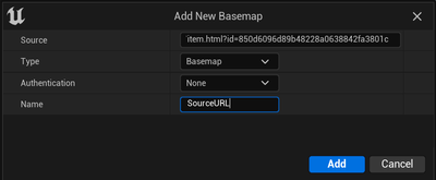

I've tried adding new basemaps using the above links as the source (e.g.)

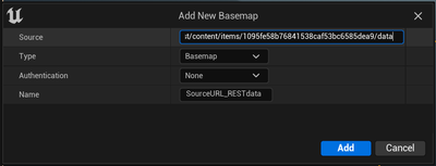

and also in the below format:

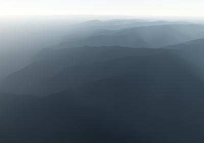

For sources in WGS84 (specifically Web Mercator (WGS 1984) - like this one is) I get no message in the logs. Neither an error, nor an "ArgCISLayer status=Loading" message. Just nothing. My landscape in the display window shows the elevation ok but with no basemap:
If I switch back to the default "Imagery" basemap, I get a basemap again, but it's the outdated one I can't use
