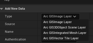

jiaqili1
I can not see your layer, I am not your member group.
But the way, the support layer format of SDK just included the below four types.
ValeriaOspitalGreslebin
Thank you! I turned my data into vector tile and then used the "Service url".
