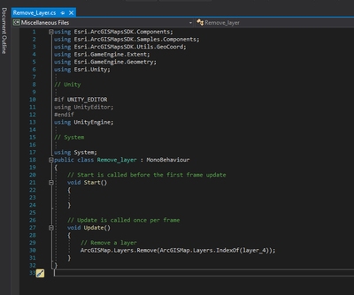

Hello,

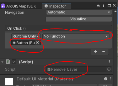

I made a button on a panel and when i push the button i wanna remove a layer.
the Onclick function on the button. But i don't know the workaround of this.
The script that must run on click button to remove a layer:

You're pretty close. Change:
void Update()
to:
public void RemoveLayer()
    Debug.Log("Remove Layer");
    ArcGISMap.Layers.Remove(my_layer);
You'll find the function in the button dropdown list that you circled under "No Function". Press play and click the button to see results

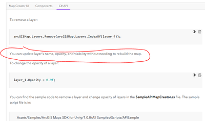

Its working now that i remove a layer in Play modus, but the Map rebuilds and ArcGIS tells this:
https://developers.arcgis.com/unity/layers/

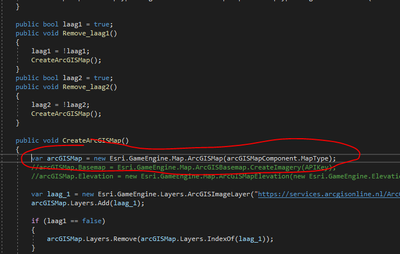

This is my code:
The var ArcGISMap is not public i think. I need push the function public void CreateArcGISMap() to remove a layer. But i don't want to rebuild the map.
Or is this not possible?
