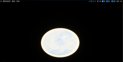

So here is a circular dataset for the artic https://www.arcgis.com/home/item.html?id=c7381cb155a043a2bba2b84566677262
You can see the content is maintained in its circle form but we are padding it with white tiles to make it a rectangle.
You can use the map's extent property to trim this down to just be the area without the white tiles
