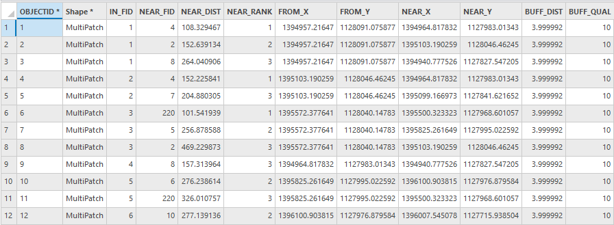

I have a hosted 3D scene layer with attribute data that I want to run calculations on inside a Unity script. Specifically, the layer is a network of lines (or rather cylinders generated with the 3D buffer tool, since the Maps SDK can't read attributes from a vector tile layer, but that's an idea post for another day) with attributes created from the Generate Near Table tool. Each line has information about its start and end points' position and FID, as well as the distance between them.

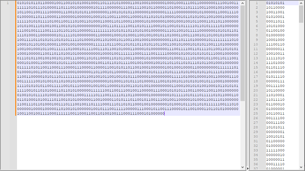

I've been trying to reverse-engineer a way to parse the ArcGISAttribute.Data stream as floats. I can get the byte stream the float attributes are sent as with ArcGISAttribute.Data, but I don't have much experience working directly with streamed data like this. I've been looking for a pattern that lines up with the mantissa + sign + exponent format C# stores floats in so I can know where to start parsing the stream as floats, but so far no luck.

Aaand not one hour later I realized what I'd been doing wrong this whole time! The attribute was actually a double, not a float! Using the correct datatype in NativeArray.Reinterpret() parses the data stream easily. 😛
