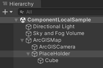

Attach an empty placeholder component as child to the ArcGISMap component.image.png

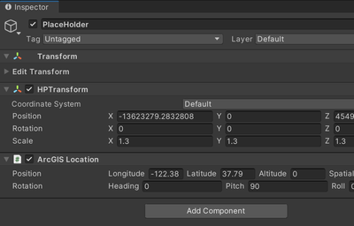

Attach both an HPTransform component and an ARCGISLocation component to this placeholder component.
The HPTransform component can be used to scale all the childs of the placeholder component. Add childs below the placeholder components that should be scaled.
