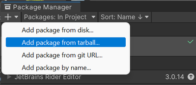

Download the arcgis-maps-sdk-unity-1.0.0.tgz file from: https://developers.arcgis.com/downloads/#unity
then import it to unity using the pkg manager.

As mentioned above the download is separate. To import choose the Package Manager option "Add package from tarball..." then browse to the tarball you downloaded.
