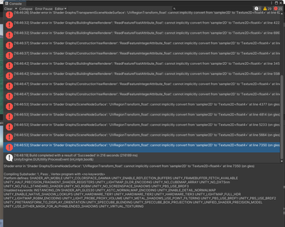

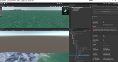

I want to Buiding ArcGIS in Android ,and I can get a apk but there is some shader error after buiding .it make my app can not work. Error writte that some shader graphs's shader cannot implicitly convert from 'sampler2D' to 'Texture2D<float4>'

It looks like you might be using HDRP? https://docs.unity3d.com/Packages/[email protected]/manual/index.html
HDRP does not support OpenGL or OpenGL ES devices.
Try switching to URP

thank you for relay
URP also have this problem
