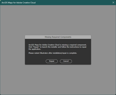

After updating to Adobe Illustrator 2025 (version 29.0), the ArcGIS map extension will not open. It returns a "missing required components" error and prompts to run repair and restart Illustrator after repair is complete:
But after running repair, it comes up with the same error. Fortunately, I can go back to the previous version of Illustrator and the extension works just fine. I'm guessing the extension needs an update to work correctly with the new version of Illustrator. Can we get that, please? I really don't want to keep using the old Adobe version.

@DaveWiosna We can reproduce the repair function issue internally and are investigating the problem. The current version of ArcGIS Maps for Adobe 3.7 supports Illustrator 2024 through version v28.7.1. The team is currently working on a new release that fully supports Illustrator 2025 (v29). The new version will come soon.
In the meantime, you can still run v3.7 on your Illustrator 2025 (v29) at your own risk. After you upgrade Illustrator to v29, you can try uninstalling and reinstalling ArcGIS Maps for Adobe 3.7 to resolve the repair problem. Hope this helps.

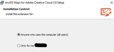

What language version of Illustrator are you using? After some investigation, we found the repair function has a problem in the non-English version of Illustrator when it is installed using a per-user configuration instead of a per-machine configuration.
To work around the problem
• Install Maps for Adobe using the per-machine configuration if possible.
• If you need to install using the per-user configuration, you should install Maps for Adobe on an English version of Illustrator.

I have the same issue. I tried uninstalling and reinstaling ArcGIS Maps for Adobe 3.7, but stilll have the same issue unfortunately. And don't have access to older versions of Illustrator now, due to company policies.

When installing ArcGIS Maps for Adobe 3.7, are you installing for "Anyone who uses this computer" or "Only for me"?

Thank you Ashley. I have a colleague who's Illustrator still hasn't updated, so I will get him to help me in the meantime, and I can wait until the update release mentioned by XingdongZhang. But just for your info, I'm running Windows 10 Enterprise. Illustrator 2025 got installed first, and then I uninstalled my old ArcGIS for Adobe (when I realised it wasn't working), downloaded v3.7 and installed that in the default path for "anyone who uses this computer".

Is there a solution in the works? I am unable to roll back to previous versions of Illustrator so must use the new release. Uninstalling/Reinstalling does not work, nor does running the repair process. After running the repair, I re-start Illustrator and still get this same error message.
