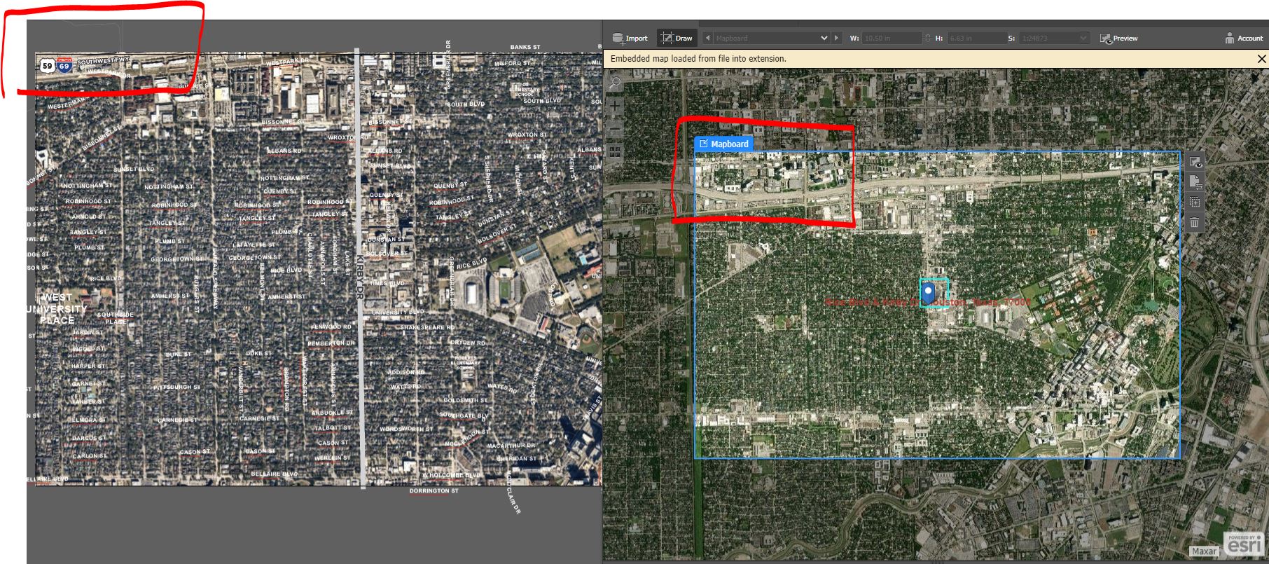

I have a user that is having an issue with the map extent when syncing. The map extent is set in the mapboard window and reflected accurately in the compilation window, however when she syncs, the map extent does not match - it seems to be more zoomed in than she set it to be and cuts off features (see screenshot).
This only happens occasionally and I have not been able to recreate it on my computer. Has anyone else seen this?

Thanks for reaching out! This looks very similar to one of our known issues. You mentioned it only happens intermittently, but are there any specific workflow steps you can add? Can you clarify what dpi was being used?

Thanks for replying! Below are a few bullets from the user that is having the issue. One thing I'm noticing in their comments under artboard size is "using set artboard size: current" - I'm not exactly sure what they mean. I can get clarification if that would help.
  • Artboard size varies, but usually setting up for 10.5 in w x 6.625 in h, or using set arboard size: current
  • Preview: using Imagery base
  • In compilation, using Imagery base map, then adding Add Content > Add Layers > My Favorites
    • Nearmap US Vertical Imagery +
    • Majority of time other favorite layers too
    • DPI: 250
    • Wait for drawing to load
    • Then sync
Thanks,
Chris
Anna_Breton
Hi Chris,
Thanks for the details! Yep, this is related to your user changing the dpi. If they keep the dpi set to the default value, they shouldn't run into this. Stay tuned for updates on this in the future.

Thanks for the info! We often sync Nearmap (high res aerial imagery) with the extension, and therefore need to set a higher DPI for the image quality. As I mentioned, I've never had this issue with the map extent not being correct, but I would say 9.5 times out of 10 we are setting the DPI to 250-300 because we're syncing the imagery... any recommendations for working with imagery layers that require a higher DPI?

For now - since the issue is intermittent - we can have a GIS professional generate the basemap in Pro and send the file to the designer. You mentioned this is a known issue, is it something that is going to be addressed and updated in the future?

Yes, a fix for this is targeted for our next release. Thanks for looking into getting the file!
