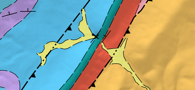

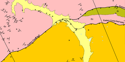

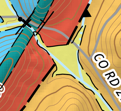

DIscovered a new problem in AIX export where one line symbol will not export to the AIX (in this case it is a thrust fault, concealed symbol), somehow the lines are missing. It is not an issue of the lines not getting symbolized in the AIX file or an unrecognized font, they're gone from the layers entirely in Illustrator. I tried checking/unchecking "convert character marker symbols to polygon" and didn't fix the issue. Also, replicated the same problem on a colleague's computer.
In Pro
In the AIX, and subsequently the AI file

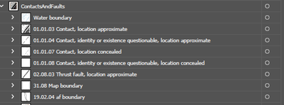

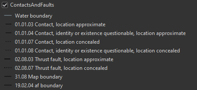

Still having a similar but different issue in Oct. 2025. Without fail, most times I export a map from ArcGIS Pro to aix, some line symbol gets broken and the paths do not display correctly. It usually is a dashed fault line that gets corrupted, but we also make a lot of maps with the thrust fault line type! In this instance, the thrust fault, dashed (location inferred) line becomes a solid line when exported to aix. Convert character marker symbols to polygon and embed fonts is checked upon export.
In Pro -
In aix -
My inefficient solution so far is to save as a pdf, open the pdf in Illustrator, select all the broken lines and paste in place into my illustrator file - only works of course if your extent and scales are the same.
