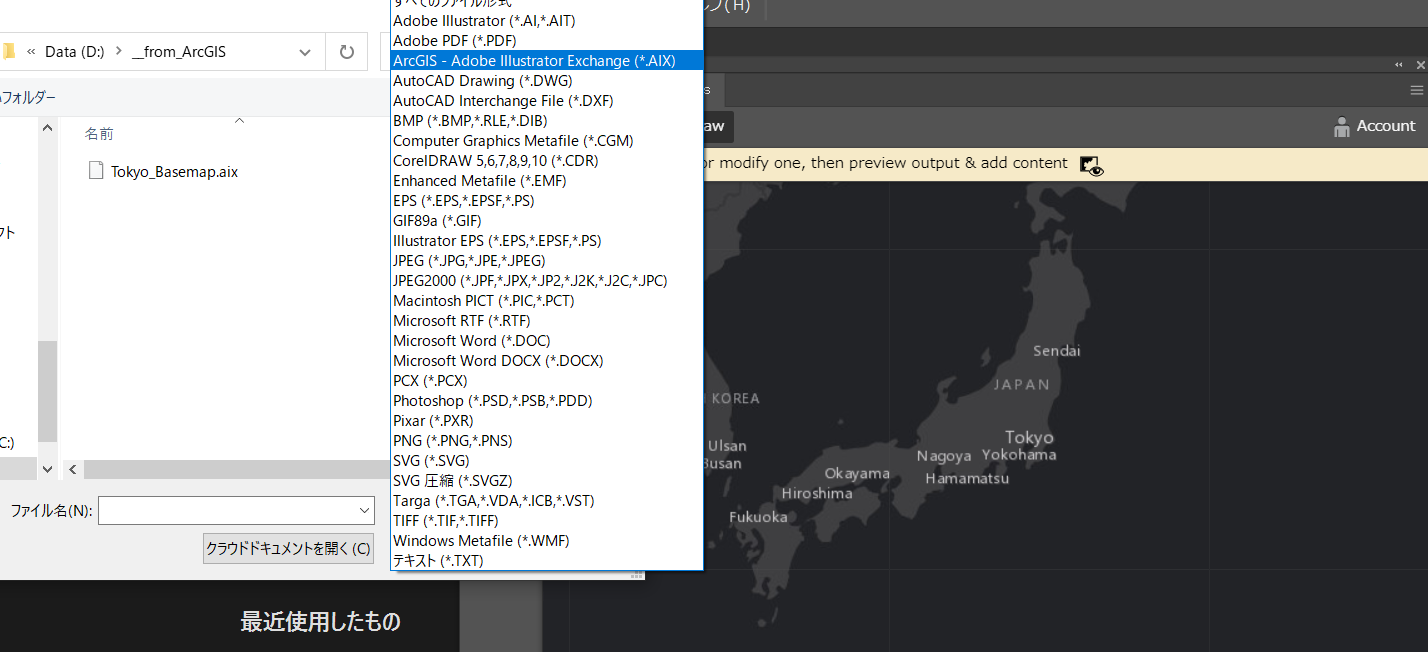

After repeating the steps instructed to you, I am finally able to read the AIX files. Thank you!
However, I have not see AIX icon yet, but I can see AIX extension on the list. (see attached png)

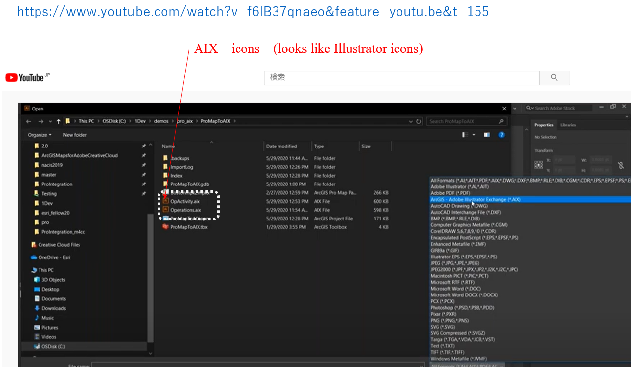

What I call an "icon" refers to the way an AIX file looks when loading a file in Illustrator.
I attached an image, which I found on YouTube, when loading the AIX file. The file looks like an "icon" like the one in Illustrator.
It doesn't look like this on my PC. (just looks like a blank paper icon)

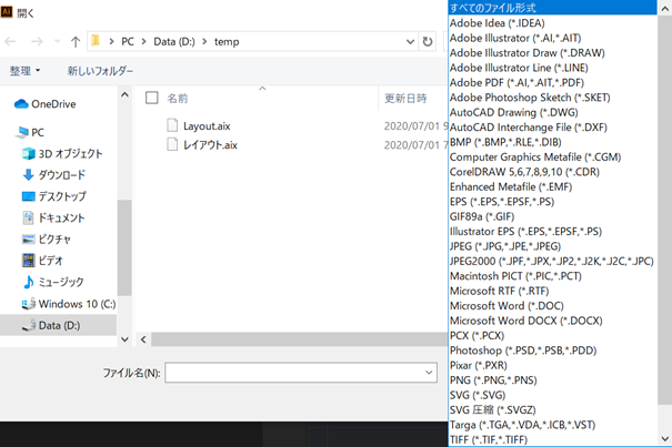

I have two versions of Illustrator (23.0.1 and 24.2.1) and both have the same Extension (ArcGIS Maps for Adobe Creative Cloud).
In version 24.2.1, "AIX" is displayed in the list of readable file formats, but It is not listed in version 23.0.1.
(please see attached image)
I know Japanese version is not supported yet. I hope it will be fixed near future.
