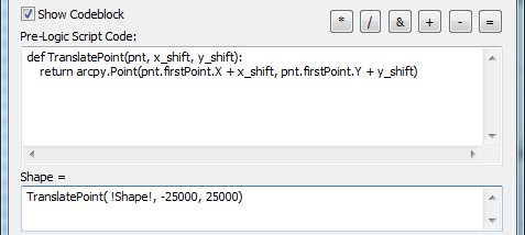

  • Let's first move the points using the FieldCalculator. Calculate the Shape field as follows:
The pre-logic script is:
def TranslatePoint(pnt, x_shift, y_shift):
    return arcpy.Point(pnt.firstPoint.X + x_shift, pnt.firstPoint.Y + y_shift)
At the "Shape =" part enter the formula:
TranslatePoint( !Shape! , -1 * half your cell size, +1 * half your cell size)
This will move the point half the cell size to the left and half the cell size up to go to the upper left corner.

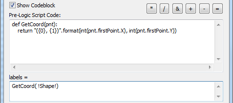

The next step will be to fill the labels field with the text for the labels; calculate the "labels" field:
def GetCoord(pnt):
    return "({0}, {1})".format(int(pnt.firstPoint.X), int(pnt.firstPoint.Y))
At the "labels =" part enter the formula:
GetCoord( !Shape! )

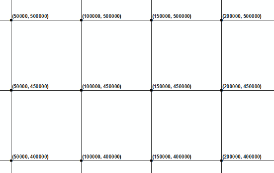

This will create a text of "(Easting, Northing)". Use this field to label the points to get something like this:
