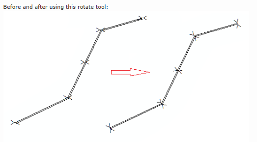

Not sure, but the Align Marker To Stroke Or Fill (Cartography) tool may be what you are looking for:
ArcGIS Help (10.2, 10.2.1, and 10.2.2)
It requires an Advanced (ArcInfo) license.
