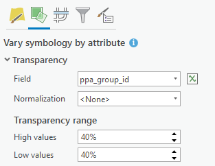

KirstenHazler
I can't tell if you're in ArcGIS Pro or not, but you can do this in Pro for sure. Use the "vary symbology by attribute" option. If you want all the polygons in the layer to have the same transparency, you can use any arbitrary field, and then set the high and low values of the transparency range to the exact same thing.

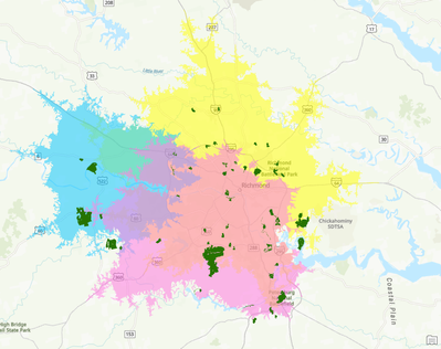

I used the setting shown above to map overlapping service areas for three parks. Works nicely using the CYM colors.
