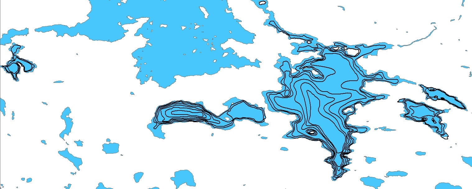

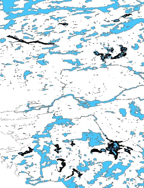

I am using ArcMap Desktop.  I have a shape file with contour lines for about eight lakes in an area of about 15 square miles.
The picture below is to give an idea of the distance between lakes and the picture at the bottom is a more zoomed in view of some of the lakes.  I already have DEM data for the white area in the pictures.  I would like to use the contours lines in the lakes to make DEM data which I could then adjust to make the shallower water light blue and the deeper lake depths a darker blue.
I tried using the TopoToRaster tool but it thinks the area between the lakes is part of the lakes and make dem data for the entire area. Can the TopoToRaster tool do only the lakes with the contour lines?  How?  Or, is there there a better tool for this?

For map making and not analysis, I would just overlay the vector lakes over the raster.  Your lakes are too small to effectively show the depths unless you used an incredibly small cell size and topotoraster and then combined the dem and the raster lakes (using con).  The rasters would have to the same cell size, which would cause issues with the dem since it probably isn't at the same resolution as would be required for the lakes.

Topo To Raster is the tool you want. It is a spline interpolator so it needs to create a continuous surface.
I suggest converting the lake polygons to line and  assigning them an elevation on the coastline (0 if these are depth contours), and add them to your contour data set. Then run Topo To Raster and clip the results to the lake areas.

If you go the polygon to line route you would have to use left-right topology to assign min and max elevations to the polygons. This is a little bit challenging database wrangling but it is doable, using the left and right poly object ids to do joins.
