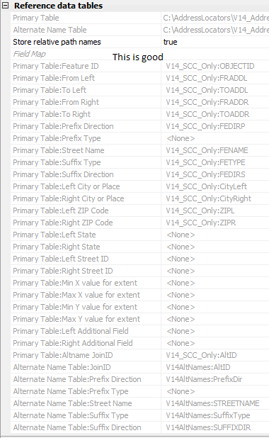

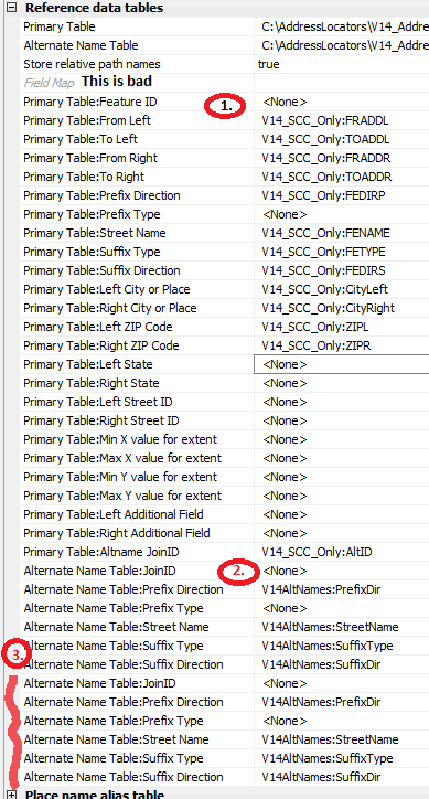

There I look at the Reference data tables section. In the field map (see attached):
  1. the primary table has FeatureID set to none, and OBJECTID isn't available in the drop down
  2. the alternate name tables JoinID is set to none, although it is available in the drop down
  3. the fields in the alternate name table appear twice
If I set any of the missing values and click Ok, ArcCatalog shuts down immediately with no messages. On re-opening it, no repairs have been made.
