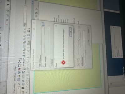

Is it possible to checkout Nautical Replica when using a file geodatabase. I can’t create products without taking this step and I’m currently on a file geodatabase. Is it also possible to create versions in a file geodatabase. This is the response I get

@GabrielAweya This tool only supports enterprise geodatabases. You can read more about replication here: https://desktop.arcgis.com/en/arcmap/10.7/manage-data/geodatabases/replicas-and-geodatabases.htm
You can create your data directly in the file geodatabase or you can install a database server on your machine and create the NIS database on the database server. This will allow you to use versioning and replication: https://desktop.arcgis.com/en/arcmap/10.7/install/database-server-desktop-engine/intro-desktop-datab...
