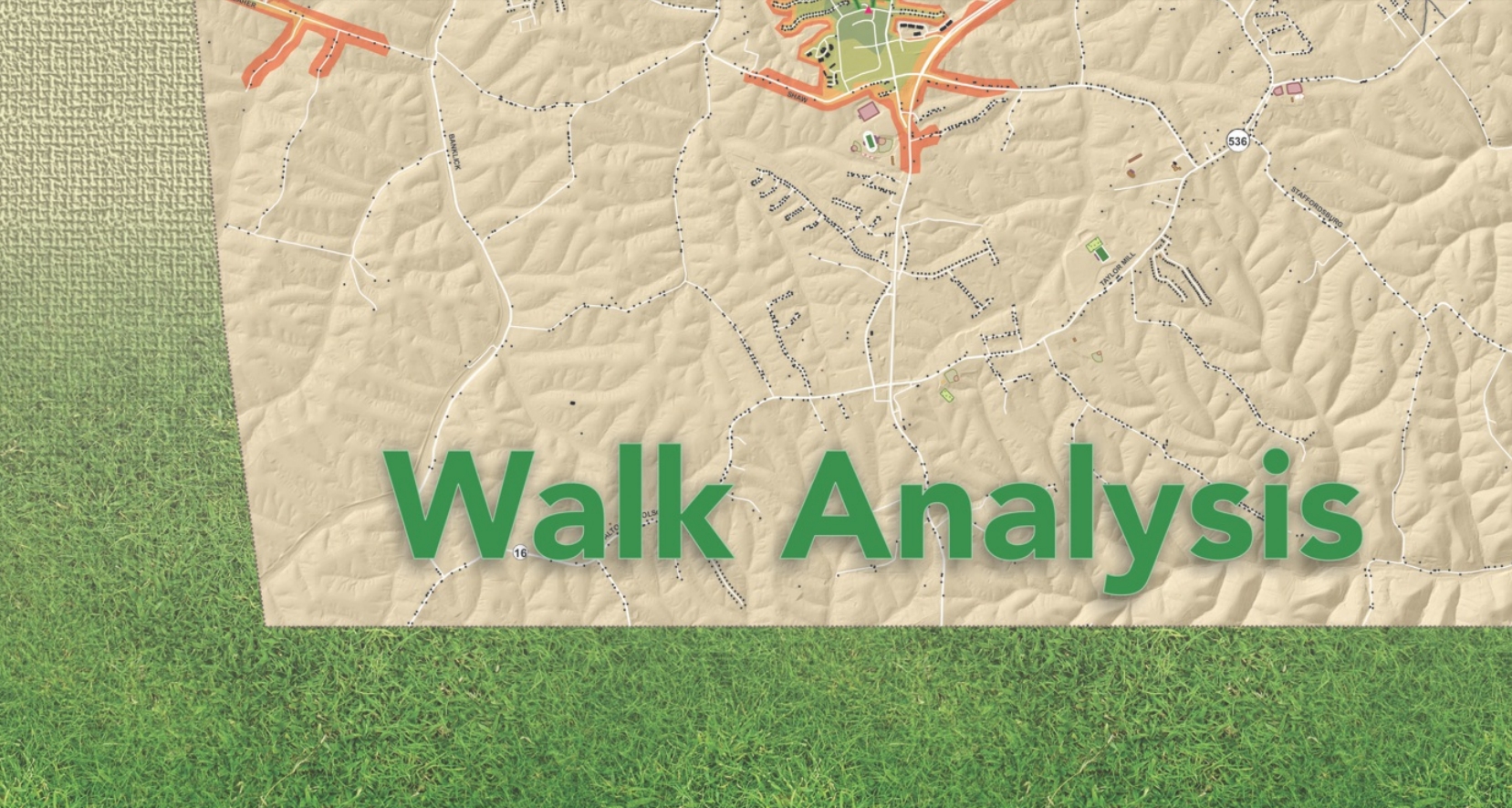

The following image shows the "bottom" of the map, but that is not the county boundary, it's just the southern-most extent of the map.  Sort of a "best fit".  The dashed line on the bottom/south is not actually a boundary.  Just an arbitrary stopping point.  I'm thinking there is a specific symbology or design element to use there which is more universally accepted.

I'll just say, "no", but I'm not really one to spend much time looking for standard ways to do things. I spend all day looking at maps, so if I don't know "the standard way to symbolize" something, how would a general map reader know? Do something that makes sense to you. Show it to someone else. Does it make sense to them? If so, it's probably just fine.
With that said, there just may be a stickler out there that knows how you're "supposed" to do this.
