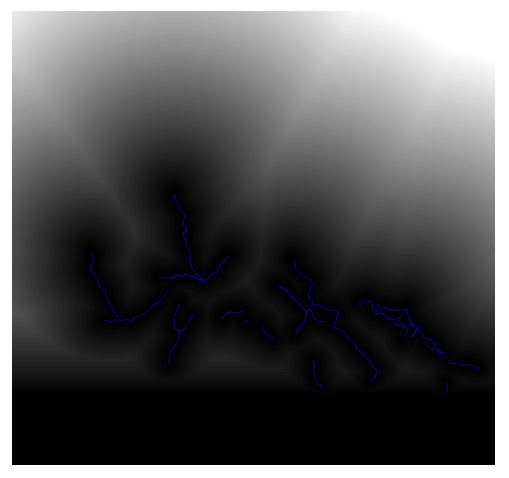

The output of my Euclidean distance from Roads seems to show the calculations only until the last feature ot the bottom. The process extend goes on though, but shows wrong values. It should get brighter instead of being dark (like on the other sides)
With dark beeing close to roads and bright further away.
What did I do wrong/ Do i have to do to get raster values to the full extend of the processing extend?
Note:I got this feature (mainroads) by deleting some other features (sideroads) from the original feature (main and side roads). The above mentioned problem does not occur with the original feature.

What is in the legend?
What are the value ranges?
When you say they are wrong, what is this based on?
Have you inspected the pixel values?
TobiasSchulz
Thanks for the response!
The distance is measured in meters and ranges from 0 to 32805,6
They are wrong because the pixel values in the lowest extend part tell me that they are on a road (all Pixel values are  0 ), although there is no road feature (blue) near them.
So it looks as if ArcGIS thinks, that to the lower extent limit(everything lower then the lowest actual road feature) is a road too? Does that make sense?

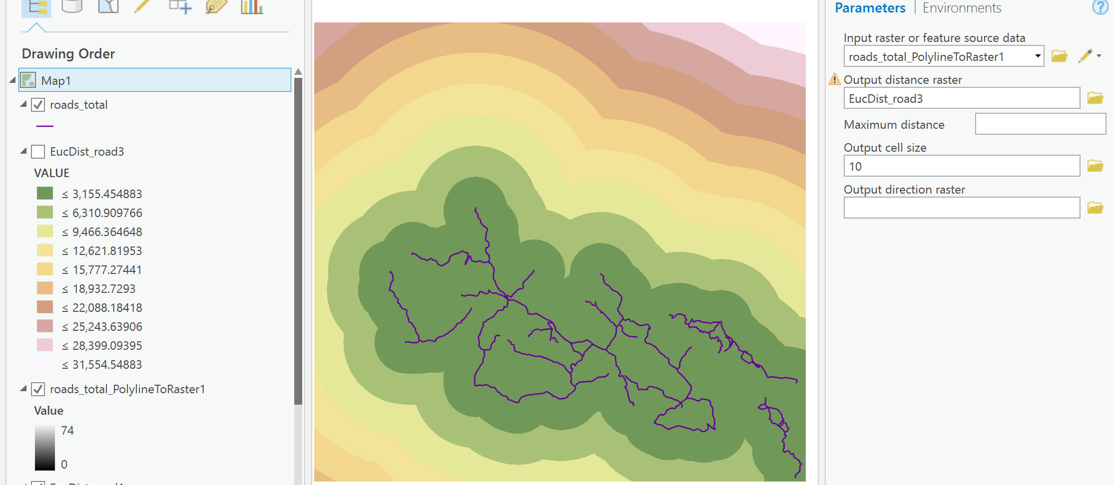

DanPatterson_Retired
MVP Emeritus
This is what I got
I use the Working_extend_r10 to determine the cell size, the extent and the snap raster.
I did it with both the featureclass and the featureclass converted to a raster... using the above set parameters.
I got this in both cases.
the other extent raster was crooked
the other featureclass I dumped since it appeared it was part of the total
anything out of sorts? from what you did?

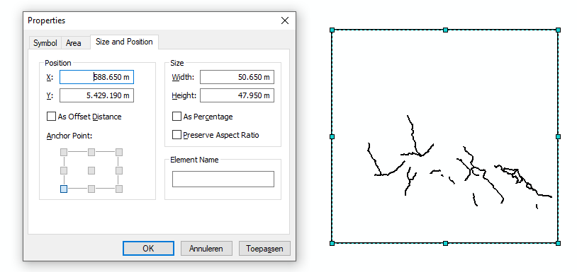

It really is not necessary to convert the roads to raster before the euclidean distance calculation. It all depend on the used extent.
This is you result that you included:
This is the one I calculated using the selection of roads in roads_cat1:
In case you don't have a first raster to use as extent and snap raster, you can set the extent using values in the environment settings. I noticed that the extent you used look like this:
When possible define the values of the extent as rounded values and multiples of the cell size. You can use a rectangle and draw that around the data to define the coordinate:
MVP Emeritus
I used Working_extend_r10 to define the extent Xander, as well using it as the snap raster and to determine the cell size.  Converting the roads (the full set, not the partial set one) to raster used those parameters as well to ensure that everything has the same environments..  Ditto for the Euclidean distance.  I suspect it was a mishmash of mixed inputs, so I didn't even try to replicate what was observed.
