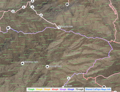

I have been asked to provide a map similar to this one from CalTopo showing wind speed and direction.
I see that Living Atlas has this layer https://www.arcgis.com/home/item.html?id=cb1886ff0a9d4156ba4d2fadd7e8a139  but it doesn't have the same wind direction lines as the Caltopo map.
Is there an AGOL version of this type of data?
Thank you,
Mele

Hi Mele,
I don't know the CalTopo map you're referring to. Looks like those are animated flow vectors. Those cannot be generated from the station data you referred to. Flow renderer in AGOL requires raster data.
