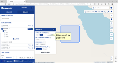

Not sure if you are aware of the new browser available through Copernicus ( https://dataspace.copernicus.eu/browser/ )... something you may find useful. I believe it was created for Copernicus by Synergise (maker of EO Browser, and similar to that resource). The new browser has some improved utility, including ability to search by platform and view the full resolution result. This may help you address the issue you are trying to resolve.
