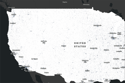

A huge swath of Northern/Central California, western Oregon and western Washington are missing from the "Authoritative" USA NLCD Impervious Surface Time Series Image Server. It is clearly visible in this map with all time series dates included. We use this layer for a ton of daily/dynamic processing in our org and lots of things are broken as of late as a result of this layers issues. Please advise.

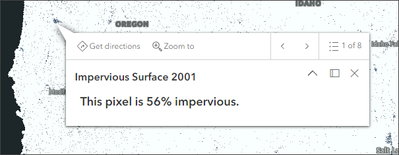

I checked the image service, and it all seems to be working just fine. Here's the map I just viewed using that service:
I'd suggest the obvious - clear browser cache and give it another go.

PatSmyth
@BernSzukalski this issue appears to be happening again. Attached is the screen shot of what I see when opening living atlas NLCD impervious surface. No errors being logged to console but visually AND when I attempt to run zonal stats against image service for anywhere in western US there is no data to summarize.
