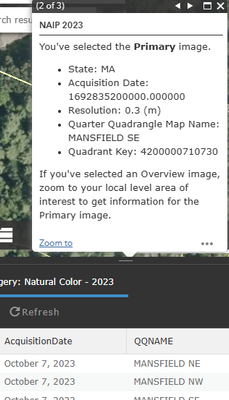

Hi all!
 I just updated my web map's USA NAIP Imagery: Natural Color layer to filter for 2023, instead of 2021.  When clicking on the map, the default popup displays the following attributes, including Acquisition Date.
You've selected the Primary image.
  • State: MA
  • Acquisition Date: August 23, 2023
  • Resolution: 0.3 (m)
  • Quarter Quadrangle Map Name: MANSFIELD SE
  • Quadrant Key: 4200000710730
If you've selected an Overview image, zoom to your local level area of interest to get information for the Primary image.
However, the Web App using my web map does NOT display the acquisition date as expected.  Instead, I get a numeric string:
  • State: MA
  • Acquisition Date: 1692835200000.000000
Yet, when I open the web app's attribute table, I do see the proper Acquisition Date.   Here is a screenshot with the popup result and attribute table result:
The popup text is simple enough:   Acquisition Date: {AcquisitionDate}
with default formatting:
The web map is used in a Web AppBuilder application configured with the Launchpad template.  The NAIP layer is set up with the subscriber content access to allow user access to this imagery.  The map/application is not public.
I tried a new map with just the NAIP layer, and a new app.   I get the same results.
I have held off on converting this application to Experience Builder as I wait for the screening widget/report functionality I need.  Hence, I am hoping I can remedy this to hold off a little while longer...   thank you for any thoughts or insights!

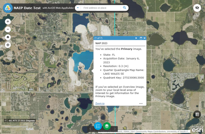

RobertWaterman
Thanks for clarifying.
I performed the following steps but was unable to reproduce the issue.
  1. Created a web map using the USA NAIP Imagery: Natural Color layer from Living Atlas
  2. Created a web mapping application using web app builder.
  3. Selected the Launchpad theme and my web map from step 1
  4. When I click the map, this is what I see in the popup:
Can you try my test app and see if you see what I see? Also, let me know if there are additional details I may be missing.

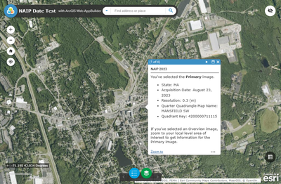

AnitaB
Hi Rob -- so, I finally have something that works!
The roundabout summary:
  1. FAIL:  As posted initially, I reset my original NAIP layer from YEAR = 2021 to YEAR = 2023.  AcquisitionDate did not display properly in Web App, only in Web Map.
  2. ALMOST:  After trying various things, I just deleted the NAIP layer, saved my map, reloaded my map, and readded NAIP.  Filtered for 2023.  That worked.  I renamed the layer. Popup date failed again.  Renaming the layer back did not help.
  3. HOORAY:  I deleted the NAIP layer. Saved and reloaded my map. I added NAIP fresh again. I filtered for 2023. However, I did NOT rename the layer. I held my breath. It works in my Web App.
Whew.  Thank you for the support - ab
