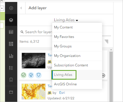

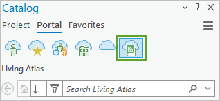

If you are searching for data within ArcGIS Online or ArcGIS Pro, switch the search space to Living Atlas.
