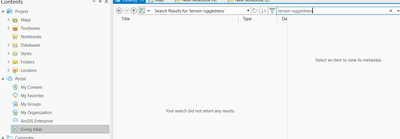

I'm trying to use this Terrain Ruggedness Index (TRI) tool in ArcGIS Pro. I tried following these instructions: "In ArcGIS Pro, search ArcGIS Living Atlas for raster function templates to apply them to your imagery layer." Searching in the Living Atlas pane in ArcGIS Pro yields no results:
Am I looking in the wrong place? The instructions are really sparse and don't seem to work.

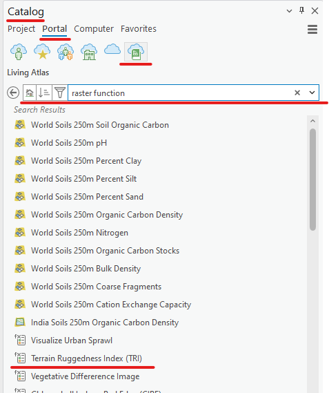

Hello
So in the Catalog pane of ArcGIS Pro:
1: Click the Portal tab.
2: Click the Living Atlas button
3: In the search box type raster function and press <return>
In the results you *should* see the Terrain Ruggedness Index (TRI) function
4: Right click the function and choose Open Raster Function.
Hopefully that should do the trick

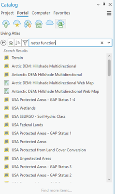

sbrowneotogo
Thanks for the reply - for some reason, when I follow the same steps I don't see the TRI. In fact I'm not seeing any raster functions, only Web Maps or Imagery Layers. Maybe there's some program setting for allowing import of raster functions?
