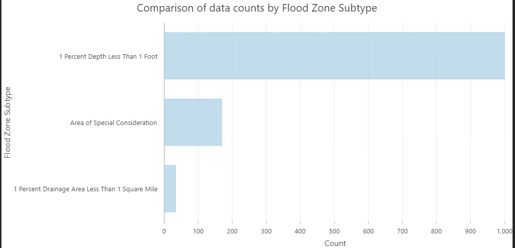

Hi I have noticed that ESRI has its own attribute called "ESRI Symbology" for categorizing the FEMA Flood zones in this Living atlas service: https://www.arcgis.com/home/item.html?id=2b245b7f816044d7a779a61a5844be23
I filtered the dataset for only 0.2% Annual Chance Flood Hazard, but I am still noticing Flood Zone Subtypes that are not a 0.2% Annual Chance still within the service after this filter is applied and I am wonder how ESRI + FEMA decided on this?
I did some digging an noticed that when the filter below is applied, Flood Zone Subtypes still shows areas of 1 Percent Depth Less Than 1 Foot, Area of Special Consideration and 1 Percent Drainage Area Less Than 1 Square Mile as an ESRI symbology of 0.2% Annual Chance Flood Hazard.
"esri_symbology = '0.2% Annual Chance Flood Hazard' And ZONE_SUBTY NOT IN ('0.2 PCT ANNUAL CHANCE FLOOD HAZARD IN COMBINED RIVERINE AND COASTAL ZONE', '0.2 Percent Annual Chance Flood Hazard', '0.2 Percent Annual Chance Flood Hazard Contained in Channel', '0.2 Percent Annual Chance Flood Hazard Contained in Structure', '0.2 Percent Annual Chance Flood Hazard in Coastal Zone')"
This seems incorrect to what documentation FEMA has on their site. https://www.fema.gov/glossary/flood-zones
Again I am just looking for some clarity as to how the "esri_symbology" category was curated.
Thanks!!

Hi Robert,
In 2018 I reached out to FEMA for advice on symbology. They sent me two MXDs they used to symbolize the layer for their own services. In that, they used combinations from two categories in the FEMA flood zones to create a symbol: FLD_ZONE and ZONE_SUBTY. Some of the combinations seemed contraintuitive so I reconfirmed with them, and the result is what you see in the feature and image layers in the Living Atlas.
Every year, sometimes twice a year, a script is run against the FEMA flood layer update to assign the esri_symbology field from these fields: FLD_ZONE, ZONE_SUBTY. Then the layer is updated with that.
You found some of the more unusual combinations which led to symbols receiving a 0.2% flood hazard color, it seemed strange to me too but I got confirmation from the agency August 1, 2018.
The symbols they recommended seemed more about people understanding the layer more than simply assigning a color to a code, so the symbology was well received as a "front end" to the dataset.
Every polygon is put through the following decision tree to determine its esri_symbology value (row[2]). The result is an integer between 0 and 15 and that value is also rasterized to create the image layer:

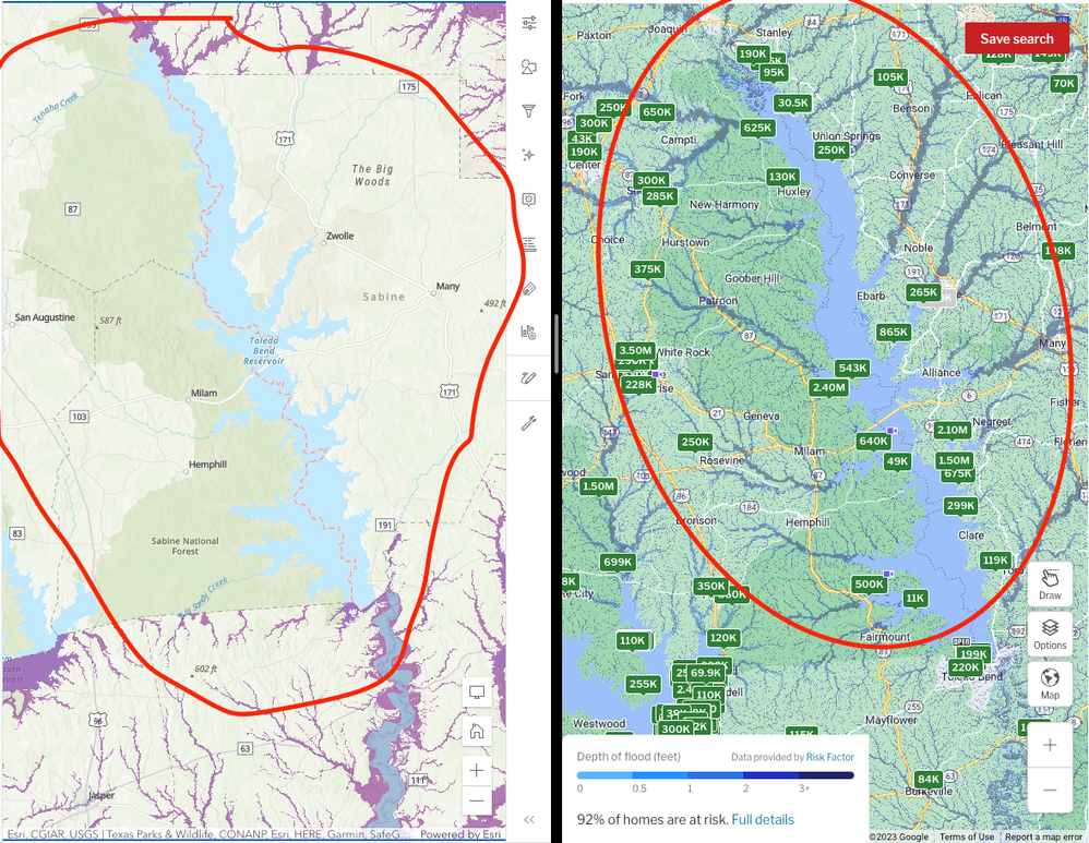

Hi guys, I need to generate raster tiles for fema floodzones
wondering which software/tool have u used to process the entire United States and how much computing power do I need (ram, cores, etc)
do u process it all at once or some chunk strategy ? Do u simplify the poligons in some way ?

NicolasGrapsas
New Contributor
Hi Michael, thanks for the quick reply and detailed information, it was very helpful !
I've been able to generate the raster tiles for a given subset of texas.
While i was reviewing the results, i've noted there are some missing polygons (compared to redfin.com floodzone map)
I think the living atlas has the same problem as my version (attaching screenshot: redfin vs living atlas)
Do u know if its due a processing error or if its a fema probelm and redfin may have a different source of data ?

Michael_Dangermond_Content
Hi Nicolas! It looks like their source begins with FEMA as a point of departure and models flood risk for the rest of the USA. Their map says their data source is risk factor. For a reality check to see if a flood zone you see matches FEMA I would use the agency's own flood hazard viewer found on this page. Living Atlas team knows that there are a lot of ways to work with flood risk and we appreciate the efforts to model flood risk around the USA, but in this layer we stick close to FEMA because our customers also want to know what's legally required of them by these flood zones, at as high resolution as is practicable. Living Atlas Team also serve a layer put out by NRCS the soils people called USA SSURGO Flooding Frequency, which shows how often a soil map unit polygon is expected to flood. This has better temporal resolution than FEMA, but less spatial resolution, as detailed in this blog.
