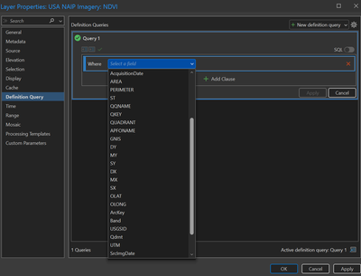

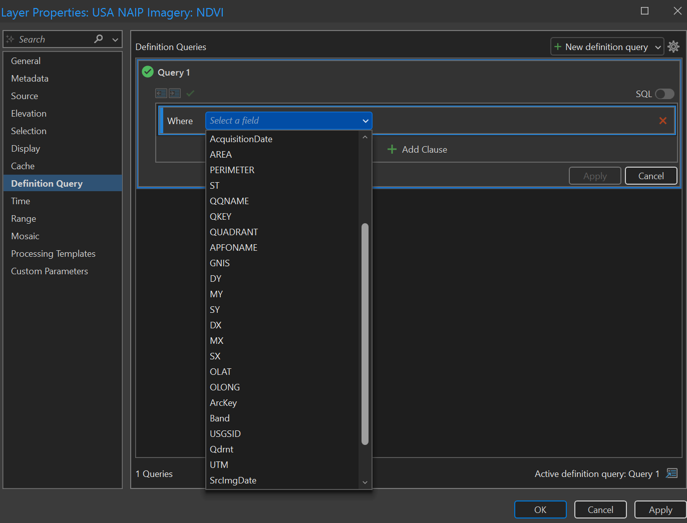

I am interested in extracting the latest NDVI and NDWI (I believe the latest data for IL is from 2024 correct?)  for particular seasons in IL (or particular areas within the state) from the following imagery
USA NAIP Imagery: NDVI
Would it be possible to filter out data for particular start and end dates, like for example Spring leaf off seasons?
What attribute will I use under Definition Query?
@RWaterman can you please help with this? thank you

The latest NAIP data for IL is 2023.
Regarding data filtering, there is an Acquisition Date field. However, there are a couple things to note:
  1. NAIP imagery is generally collected during agricultural growing season which generally implies "leaf-on"
  2. There is only one acquisition date per acquisition year for any location. i.e. there are not multiple versions of imagery collected in 2023 covering the same location.
Let me know if this answers your questions.
