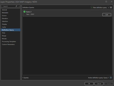

so i am interested in using 2022 NDVI from the following imagery
USA NAIP Imagery: NDVI
How can i filter this dataset to just 2022?
Would this be the right way to do it in Pro 3.4?

Hi Ed,
You are correct, that is how you would filter for just 2022 imagery. Do keep in mind the following:
  1. Once you filter for Year = 2022 you will no longer see the country wide overview imagery. The imagery will not display until you zoom in closer to the source resolution.

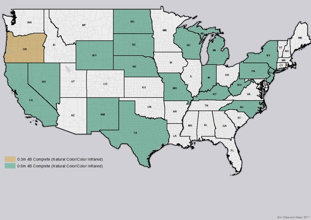

  2. Each year only about half of the states are updated. See 2022 coverage below:
Let me know if additional questions.

Hi Ed,
