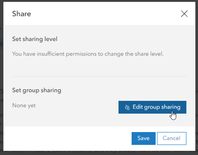

I am running into one issue with this: I am unable to share an ESRI-owned living atlas layer with the group because of the sharing permissions.
I could be doing this wrong... Do you have any insight? Maybe a screenshot?

Once you sign in at the Living Atlas website, you can go to the Browse tab to find content you are interested in. Since you are signed in, you can favorite items or even directly share them into a group that you own.
Once you sign in this should work for any and all Living Atlas content. If there is something you are stuck on, you can send me an email at bszukalski@esri.com
This blog article may be useful, I overlooked mentioning sharing to groups but will add that.
