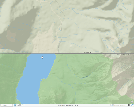

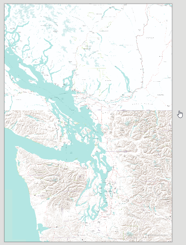

Hi,
I was directed to this forum by an ESRI support team member to address a basemap issue. I noticed that the ArcGIS Pro basemaps for Canada and the Unites States don't match:
This affects multiple basemap types and results in differences in map features (e.g. hillshade in example above, non-matching contour lines, differences in the appearance of waterbodies, etc.), and blank or blurry areas along the border. Obviously, the less features a basemap shows, the less noticeable some of the effects are. Sometimes this is also scale-dependent (in the example above, the 'switch' happens at a scale of 1:817,120). While the individual basemaps themselves might be fine when looking at them isolated, including them in projects where the border serves as a cartographic reference leads to undesirable effects and basically makes them useless. I'd be happy to provide more examples...

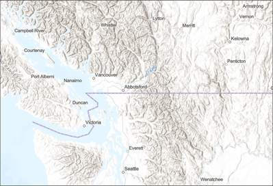

I once again went through all the basemaps and was not able to reproduce what you've captured. I even switched my locale to see if that made a difference (it doesn't). But I think I finally figured it out. I went to the now-deprecated raster tile basemaps and looked at Terrain with Labels. I was able to see a difference across the border:
So what this might indicate is that your organization is still using the deprecated basemaps, and you need to move up to the new vector tile basemaps. The raster ones are no longer updated, and you'll like the vector ones much better for many reasons.

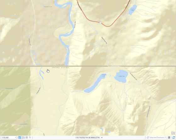

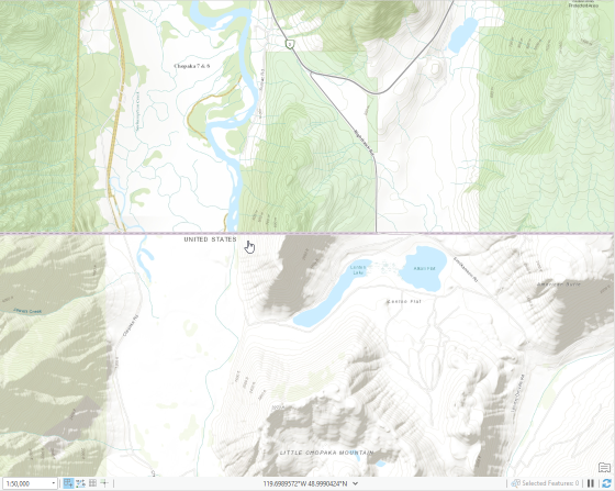

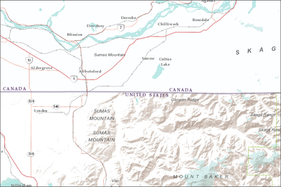

I also included some other basemap examples (all at 1:50,000 scale) with some of the above mentioned effects (near the mouse pointers):
Topographic:
Streets:
National Geographic:
Please note that the effects might not appear at every scale, these are examples to illustrate the issue - the basemaps 'switch' at different scales (please also see my original posting).
