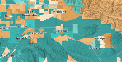

For example, here's demographic data from Living Atlas - obviously nationwide  in coverage:

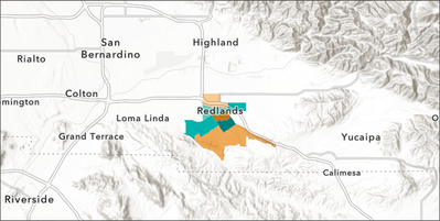

Here's the same layer with filters applied for the block groups covering Redlands only and saved as a local layer:
