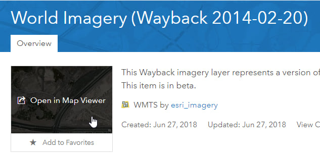

Step 2 – Open the item details and add to your map
Click the title to open the item details, then click the thumbnail to add the layer to your map.

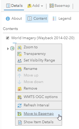

Step 3 – (Optional) Set the layer as your basemap
If you want to use the layer as a basemap, click More options (…) and Move to Basemap. After moving the layer to the basemap, you can remove other basemap layers.

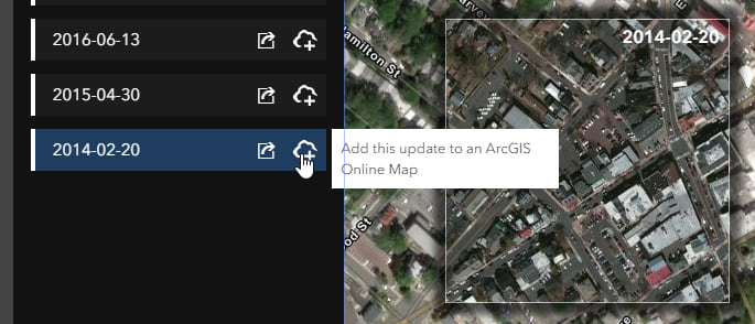

Step 4 – Select the vintage layer(s) you want to add to your map
Hover over the layers to see a preview on the map. Add layers to the queue by clicking the Add icon.
Step 5 – Add layers to your web map.
Layers you have selected are queued in the app, click Open these updates in a new web map to add the layers you’ve chosen.
