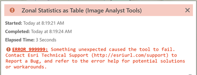

@BernSzukalski  I have been trying to use these layers to get a temporal profile for a given polygon and am having no luck.  Both Sample tool and Zonal stats fail with a 9999.  I would love to see these converted to a CRF Multidimensional Multivariate Raster.

I could give it a quick look if you send me more info about parameters you are using, extent, etc. You can send that to bszukalski@esri.com.
That said, my best suggestion for the quickest and most efficient response might be to contact Esri tech support as the message says...

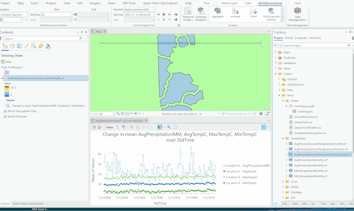

I ended up getting the raw netCDF files from NOAA and making a Multidimensional Multivariate Raster CRF file which works way better and faster.  I have been working with Living Atlas on other layers that could use this and I really hope they make the switch to this newer format.
Just look how fast this charting 4 vars back to 1895!
