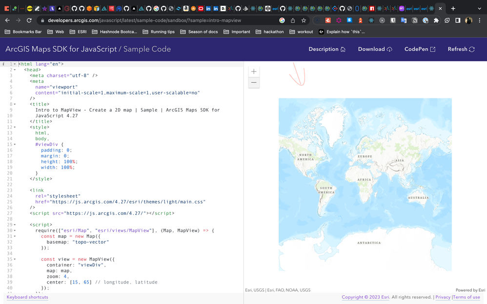

Hello,
When we drag the map  and reach the top of the map , we can see the whitespace around the map. Is there any way to solve the issue. I have attached the screenshot and the code sample for the further reference.
Any suggestions would be helpful.
Thank you.
Code sample: https://developers.arcgis.com/javascript/latest/sample-code/sandbox/?sample=intro-mapview

Hi @KarthikeyanShanmugam ,
You can add minZoom or minScale constraints to set the minimum zoom level or scale for the map view.
https://codepen.io/sagewall/pen/eYQVjbm

Sage_Wall
I just re-read the question, simply setting the minZoom constraint won't work to prevent the user from panning into the white space.  I don't think there is an out of the box way to constrain the map view to a certain extent, but I did find this older post that may help: https://community.esri.com/t5/arcgis-javascript-maps-sdk-questions/getting-mapview-to-stay-within-bo....  Instead of using the initial extent like that sample in the post is doing you would likely need to create an allowed extent and then do something similar

Try the MapView.constraints.geometry property.
Sage_Wall
Doh... I totally missed that in the doc.  I think I was looking for "extent".  Thanks @JohnGrayson
