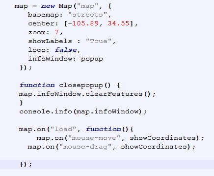

Here are some snipps of my code.
I think it might be an issue of how I'm placing my code.

  Did you put the console statement in the closepopup function, to ensure you have access to the map.infoWindow inside that function
NMWater
Hi Robert,

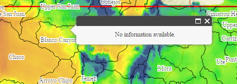

After some more careful look at my code, I got it to work. However, would there be a way to completely close the popup?
This is what I get with map.infoWindow.clearFeatures();
Before:
After:
Thanks for all your help Robert!!
Francisco
RobertScheitlin__GISP
MVP Emeritus
Francisco,
  Sure use map.infoWidow.hide();
