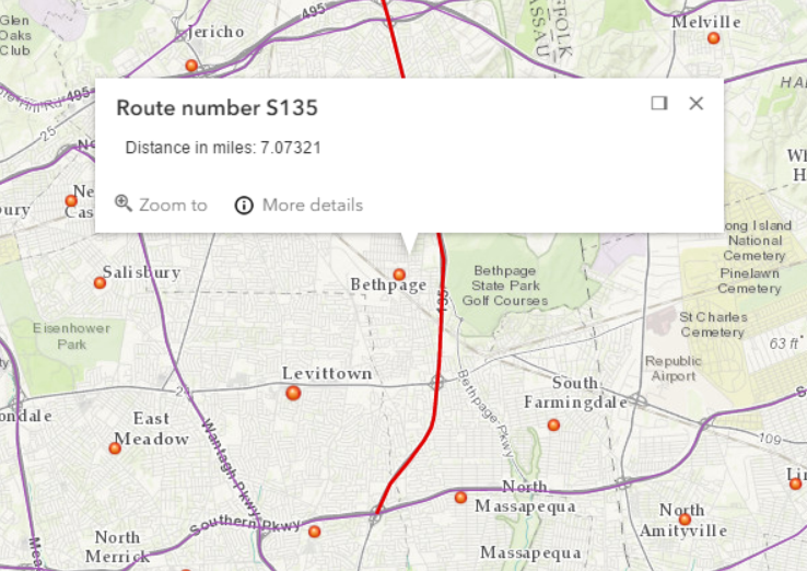

I have a scenario I am working on where when I click the sidebar with results, I need to open a popup and highlight the graphic of the selected result from the sidebar.
Although the graphic is always highlighted correctly for the polyline, the popup is not always consistently pointing to the polyline. Most of the time the popup points few inches away or in some case really far away from the highlighted graphic. Since the user is not directly clicking on the map, but on the sidebar, I need to explicitly pass the location for the popUp.
What is the best way to figure out the location of the polyLine for its popUp ?
Currently I am using the following to find the location for polyline. But as you can see in the screenshot, the popUp is displayed away from the polyline.

I am able to correctly point the popUp for point : selectedResult.feature.geometry and for a
polygon : selectedResult.feature.geometry.centroid, but for the polyLine it is not working correctly.

Not sure that there is really an easy way to do this. You could continue to do what you're already doing, but instead of snapping the popup box to the selectedResult.feature.geometry.extent.center, you could take that extent center, then pass it in to geometryEngine.nearestCoordinate() or geometryEngine.nearestVertex() to get the closest coordinate or vertex on the polyline. Then you snap the popup to the resulting geometry of the method.
But, its still probably not going to get the center of the polyline, because the extent center for the polyline can be a long way away from the polyline depending on its shape. Here's a horrible example from MS Paint!
If the red line is your polyline, then the extent of that polyline is essentially the box surrounding it. Therefore, the extent center would be the black dot, which is nowhere near the line.
Another method could be to find the middle index for the polylines paths property and try snapping to that. But again, that is all dependent on the paths and if you have a straight line polyline with only two paths (start and end) then you will have no middle to snap too.
